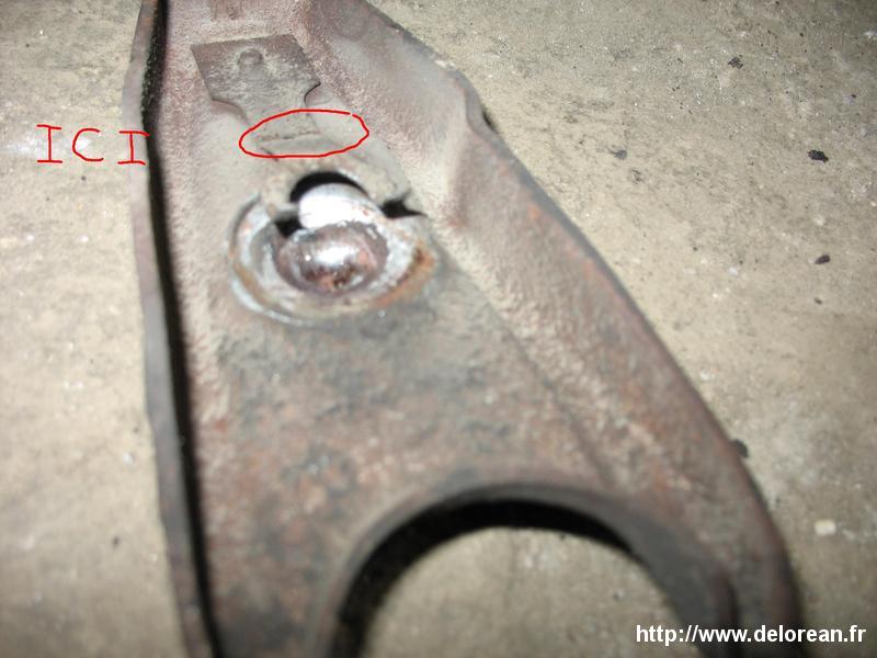

Messagepar cineman » Jeu 04 Déc 2008 à 21:30
Le Montagnard a écrit:Image
I found on my clutch fork that that little metal plate was broken. What does it do ?
Where i can found and how i can replace it?
Thanks :wink:

cineman a écrit:I found on my clutch fork that that little metal plate was broken. What does it do ?
Thanks :wink:
It's possible to repair it with another piece of steel cut with the same shape but it doesn't worth the time, you can buy the complete fork for some euros at Renault or Volvo spare parts store. ;)
BUT, it is not mandatory to change the fork just because of that small piece of steel, the fork is held in place on both side of the pivot by the clutch slave cylinder and the clutch mechanism.

Messagepar cineman » Jeu 04 Déc 2008 à 23:03
Chris_DeLorean a écrit:BUT, it is not mandatory to change the fork just because of that small piece of steel, the fork is held in place on both side of the pivot by the clutch slave cylinder and the clutch mechanism.
SO you suggest to do nothing and keep the fork that way ?

Messagepar Chris_DeLorean » Ven 05 Déc 2008 à 02:54
Yes, it the same on my car and the fork can't escape in any way and it works.
You can check yours, it should not move at all.
Chris.

Messagepar cineman » Ven 05 Déc 2008 à 10:18
Chris_DeLorean a écrit:Yes, it the same on my car and the fork can't escape in any way and it works.
Ok thanks!

Messagepar Chris_DeLorean » Ven 05 Déc 2008 à 10:33
If the fork don't move on your car, just keep it on your "todo" list until you plan to change the clutch mechanism. ;)

Messagepar Ed Uding » Ven 05 Déc 2008 à 13:02
The Clip is only there for installation, to make it simple.
Take care if you install the gearbox, that it all stay in place during installation.
Regards Ed Uding
